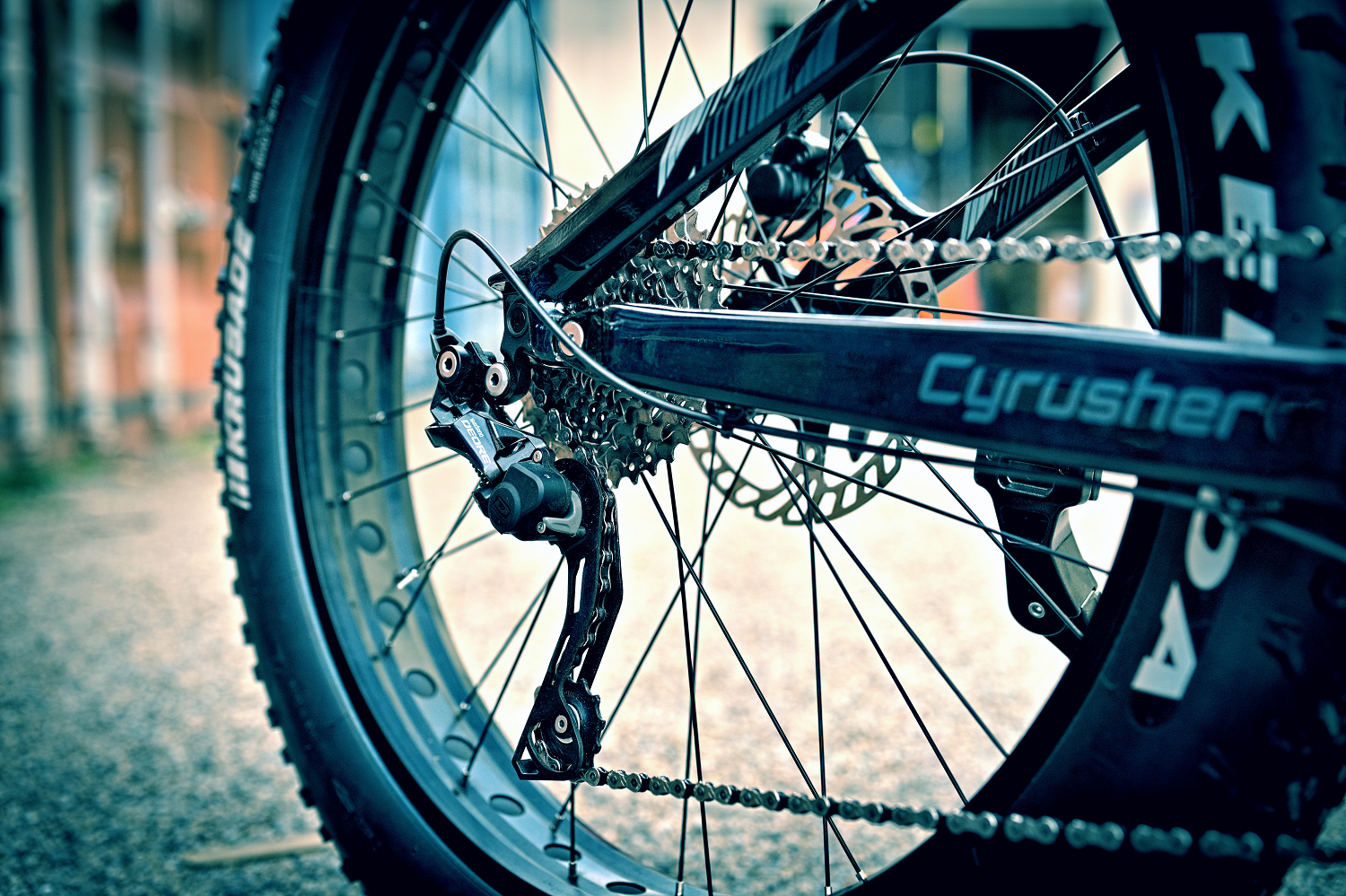

  1. Apply Cleaner: Move the pedals by hand and apply the degreaser or cleaner evenly on the chain, taking care to avoid the transmission and brake systems. If any cleaner accidentally gets applied to these areas, consider visiting a specialized repair shop for maintenance.
  2. Scrub the Chain: Use a brush and a rag to scrub away dirt and impurities from the chain.
  3. Rinse: Rinse the chain with water. It’s advisable to rinse in small amounts multiple times to prevent flushing the cleaning agent onto other parts during the rinsing process. After rinsing, thoroughly wipe the chain with a dry towel.
  4. Lubricate: Apply lubricant to the chain while moving the pedals in the same manner to ensure even coverage. Focus on the rollers and side plates. Use wet lube if you ride in wet, muddy conditions, and dry lube if you ride in dry conditions.After applying the lubricant, let it sit for a few minutes to allow for full absorption, then wipe off any excess.
